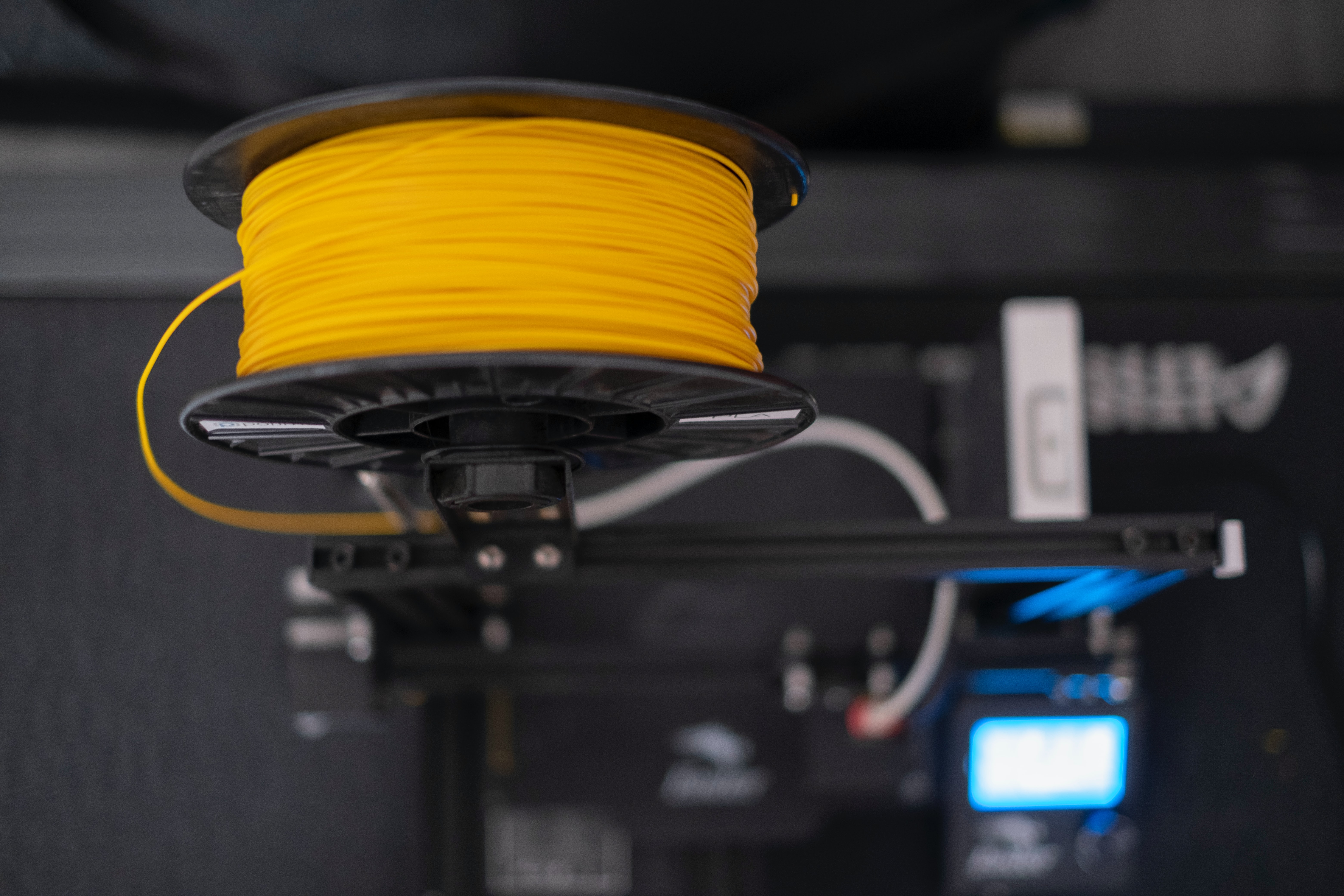

Selecting the best 3D printer filament for your FDM 3D printer is essential to getting the best results from your prints. Different filaments are available, and each type has unique properties that make it suitable for specific applications. Here are some key factors to consider when selecting a filament to help you decide which is best for your project.
